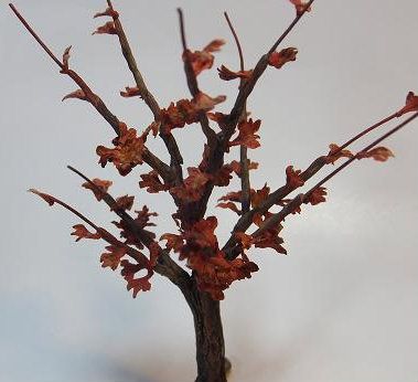

The "finished" tree, and the primed version:
Posted ImagePosted Image
I left a bit of raw wire at the top of each branch because I like how it tapers. You could trim your branches back to the edge of epoxy if you wanted. Then I painted the tree, but forgot to take picture of it before I started putting on the birch seed leaves ( see: http://www.reapermini.com/TheCraft/24, thanks Daniel Joyce!!) I painted it with reaper MSP tanned skin, washed with walnut brown, highlighted with intense brown and added carnage red to the branch tips and some areas of the bark (it's a red maple tree, which has red branch tips). Then washed the roots and a few branch junctions with reaper pro blue-black. The leaves I made using vallejo carmine red.
Posted ImageSorry about the glare here.
I used the superglue and my tweezers to place the leaves. It's easiest to start with the tree upside down balanced on it's branches, because when (not if) the leaves slip, they look more natural pointed up towards the branches. This tree is inspired by maples just after their peak, which drop their upper leaves first, Most of the leaves with therefore be clusted at the lower branches near the trunk split. Best to have a sacrificial set of tweezers you don't mind getting glue and bits of leaves stuck to...
The secret to the leaves at the bottom is actually a fortuitous mistake- some of my glue got into the leaf pile, stuck my leaves together, which I then glued on as a bunch. Hooray!
After attaching all the leaves I wanted, I pained/highlighted the leaves with some dragon red, light orange and sand yellow, just to give variety, then sprayed the whole thing in testors dullcote
