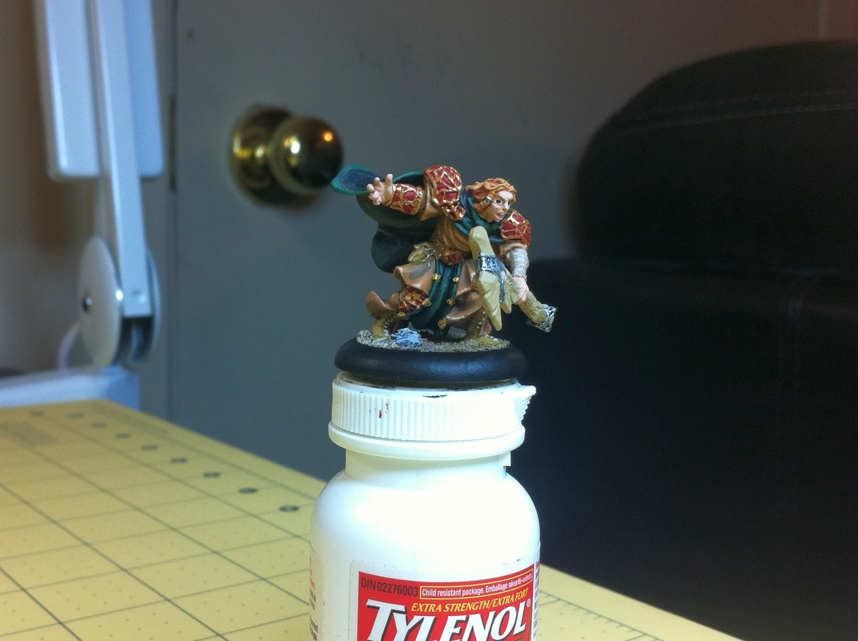

Posted 03 November 2012 - 05:42 PM

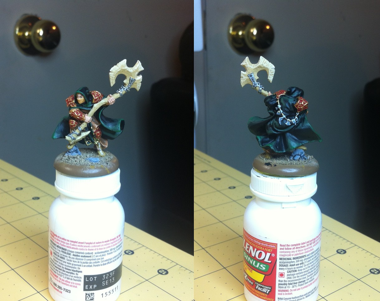

got back to working on the 4th in the unit.this one has definitely been the most challenging. trying to paint under the arm and weapon has led to many touch ups to fix unavoidable contact .
I got it mostly done i think, tho it, well, feels sloppy..I'll have to look at it again in the am and try and clean up some of the lines and highlighting. Maybe I'm rushing it abit to get thru this one..
Not sure what to do with the rock shapes on the necklace thing on his back..feels like it needs something else..but might be fine once its dipped it will help shade it.

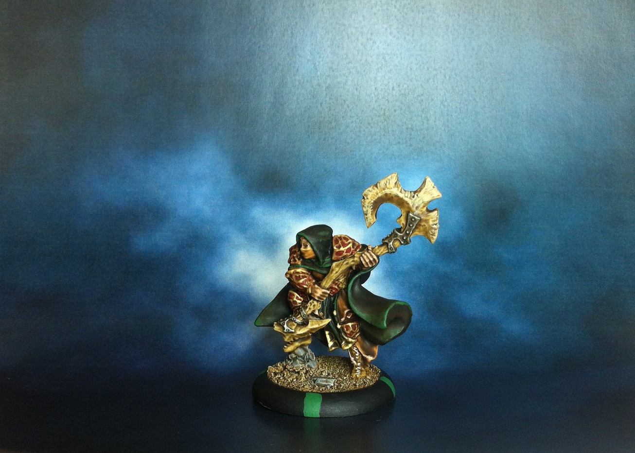

so finished up the 4th except basing which I'll do tomorrow and started on the 5th..the last two are the same figure so hopefully they'll come together pretty smoothly.
I'm anxious to do a different model in the army now after working on the same model in different poses for so long :) maybe a 2headed dog or something.
tried a different color background .blue brightens up the picture but not sure it looks better then the grey background.
Its nice to get the eyes right on the first try..well he's looking to the right, but at least he's not cross eyed or lopsided.

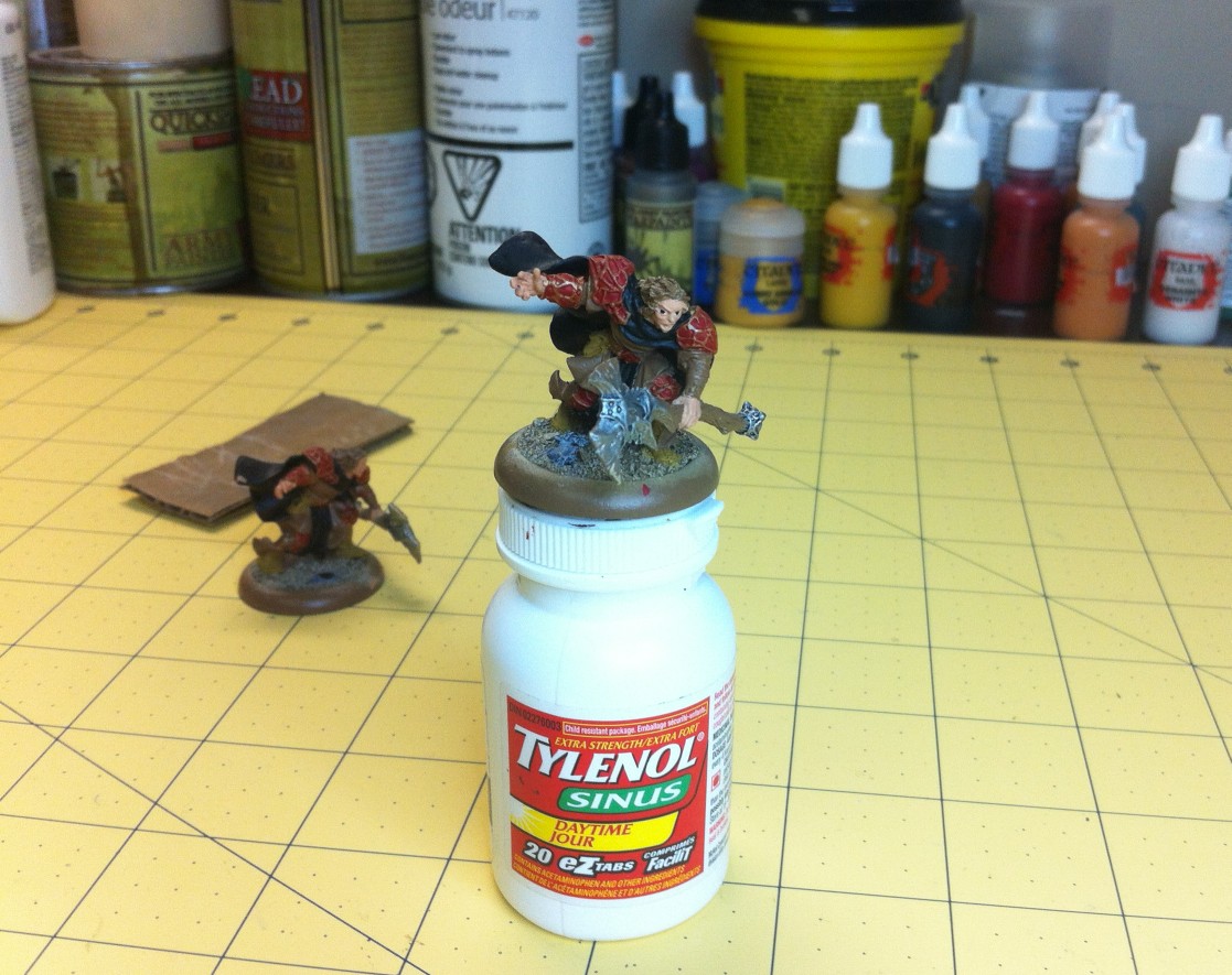

now that I got my Back2Baseix Rack assembled got to work on the fifth druid. Think he's almost done..gonna just give it a once over in the AM with fresh eyes, clean up any errors and maybe brighten up some highlights.

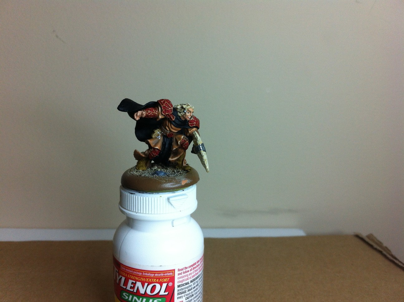

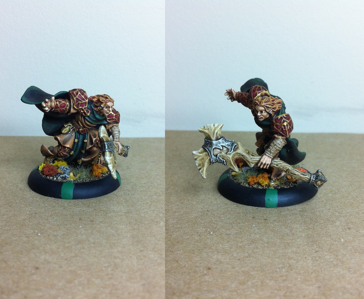

Welp I finished off the 5th. I definitely think the thinner quick shade helped. I found I didn't need to reapply the highlights after it had dried due to being thinner. I didn't re highlight the gold trim on the armor either
anyone think its to flat looking now?
I could try applying a brush on gloss sealer over those gold sections would bring out the luster in the gold/bronze sections maybe that would be enough.
Midway thru the 6th guy..trying for a blond Hair color ..it appears a bit light but I think the quick shade brown will bring it back to more a straw color

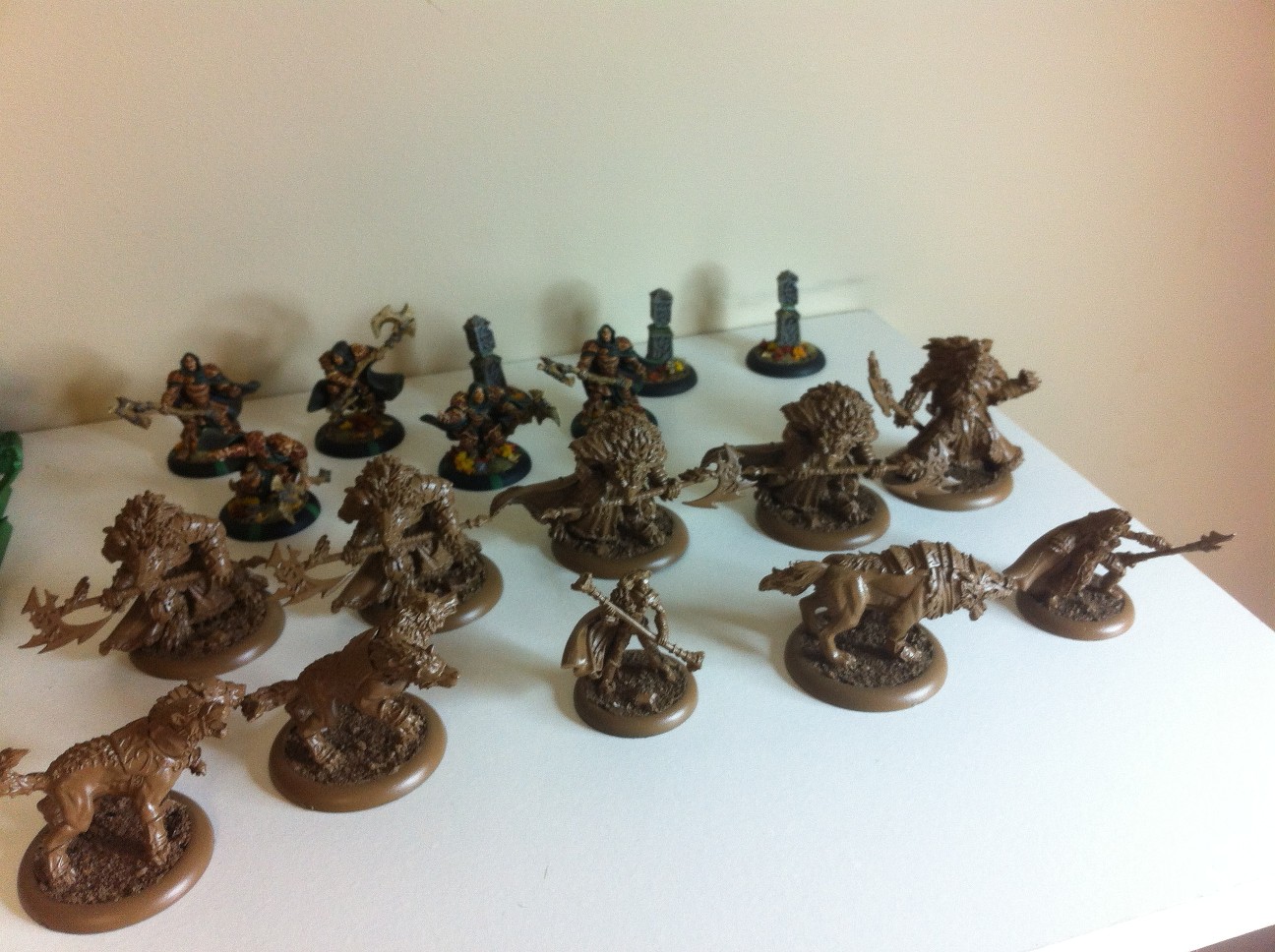

So These are the figures I have based and Primed for Orboros.No Warpwolves yet I'm STILL waiting for my LFGS to get some 1/8x1/16 magnets in for them.
So choices are Argus, Winter Argus, P Kaya, Lars and Epic Kaya. or Warpwolf Skinwalker unit of 5
Any one got a request which to do next?
